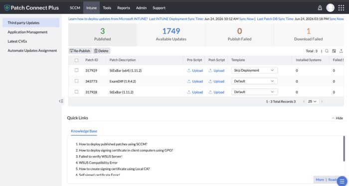

For deployments that need tighter control, Patch Connect Plus supports pre-deployment and post-deployment scripts. You can configure installation parameters, suppress user-facing notifications, force restarts, or skip the update if the application is currently running. Deployment templates let you standardize these settings across all third-party applications.
Patching third-party apps through Intune
The Enterprise edition of Patch Connect Plus extends the workflow to Microsoft Intune. It identifies third-party applications across Intune-managed devices and publishes updates directly, without the WSUS intermediary. When a vendor releases a new version of Chrome or Zoom, the product picks it up from its catalog, prepares the package, and makes it available in Intune. You control targeting and scheduling from the Intune console.
